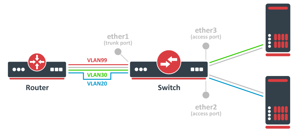

Trunk/Access port setup
Below you can find a very common diagram for a very typical type of setup that consists of a trunk port and multiple access ports:
This setup is very common since it gives the possibility to divide your network into multiple segments while using a single switch and maybe a single router. Such a requirement is very common for companies that want to separate multiple departments. With VLANs you can use different DHCP Servers, which can give out an IP address from a different subnet based on the VLAN ID, which makes creating Firewall rules and QoS a lot easier.

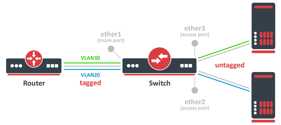

In such a setup you would connect some generic devices like Desktop PCs to ether2 and ether3. These can be considered as workstations and they generally only use untagged traffic (it is possible to force a VLAN tag for all traffic that is sent out a generic workstation, though it is not very common). To isolate some workstations from other workstations you must add a VLAN tag to all packets that enter ether2 or ether3, but to decide what VLAN ID the packet should get, you need to use a concept called Port-based VLANs. In this concept, packets get a VLAN tag with a VLAN ID based on the bridge port to which the device is connected. For example, in this setup the device on ether2 will get a VLAN tag with VLAN20 and the device on ether3 will get a VLAN tag with VLAN30. This concept is very scalable as long as you have enough bridge ports. This should give you the understanding that traffic between the bridge and devices behind ether2/ether3 is untagged (since there is no VLAN tag, hence the name).
When we have determined our untagged ports, we can now determine our tagged ports. Tagged ports are going to be the trunk ports (the port that carries multiple VLANs) and usually, this port is connected to a router or another switch/bridge. You can have multiple trunk ports as well. Tagged ports are always carrying packets with a VLAN tag (hence the name) and you must ALWAYS specify the tagged ports for each VLAN ID you want this port to forward. It is possible that a port is a tagged port for one VLAN ID and the same port is an untagged port for a different VLAN ID, but this is for a different type of setup (Hybrid port setup).
A special note must be added for the PVID property. This property should be used on access ports, but it can be used for trunk ports as well (in a Hybrid port setup). By using the PVID property you are adding a new VLAN tag with a VLAN ID that is specified in the PVID to all UNTAGGED packets that are received on that specific bridge port. The PVID does not have any effect on tagged packets, this means that, for example, if a packet with a VLAN tag of VLAN40 is received on ether2 that has PVID=20, then the VLAN tag is NOT changed and forwarding will depend on the entries from the bridge VLAN table.

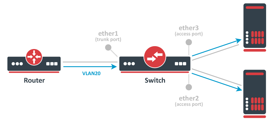

Do NOT use multiple VLAN IDs on access ports. This will unintentionally allow both VLAN20 and VLAN30 on both access ports. In the example above, ether3 is supposed to set a VLAN tag for all ingress packets to use VLAN30 (since PVID=30), but this does not limit the allowed VLANs on this port when VLANs are being sent out through this port. The bridge VLAN table is responsible for deciding whether a VLAN is allowed to be sent through a specific port or not. The entry above specifies that both VLAN20 and VLAN30 are allowed to be sent out through ether2 and ether3 and on top of that the entry specifies that packets should be sent out without a VLAN tag (packets are sent out as untagged packets). As a result, you may create a packet leak from VLANs to ports that are not even supposed to receive such traffic, see the image below.
A misconfigured VLAN table allows VLAN20 to be sent through ether3; it will also allow VLAN30 through ether2
Don't use more than one VLAN ID specified in a bridge VLAN table entry for access ports; you should only specify multiple VLAN IDs for trunk ports.

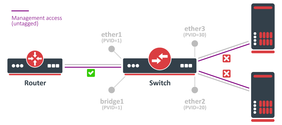

Unintentionally allowed management access using untagged traffic through the trunk port
Always check the bridge VLAN table if you have not unintentionally allowed certain VLANs or untagged traffic to specific ports, especially the CPU port (bridge).
There is a simple way to prevent the bridge (CPU port) from being added as an untagged port. You can simply set the PVID on the trunk port to be different than the bridge's PVID (or change the bridge's PVID), but there is another option, which is more intuitive and recommended. Since you are expecting that the trunk port is only supposed to receive tagged traffic (in this example, it should only receive VLAN20/VLAN30), but no untagged traffic, you can use ingress-filtering along with frame-type to filter out unwanted packets, but to fully understand the behavior of ingress filtering, we must first understand the details of management access.

Management access using tagged traffic through an access port (which makes it a hybrid port)
If PVID for ether1 and bridge1 match (by default, it does match with 1), then access to the device is allowed using untagged traffic from ether1 because of the feature that dynamically adds untagged ports to the bridge VLAN table.
But you might notice that access using VLAN99 does not work at this point. This is because you need a VLAN interface that listens for tagged traffic. You can simply create this interface for the appropriate VLAN ID and you can set an IP address for the interface as well:

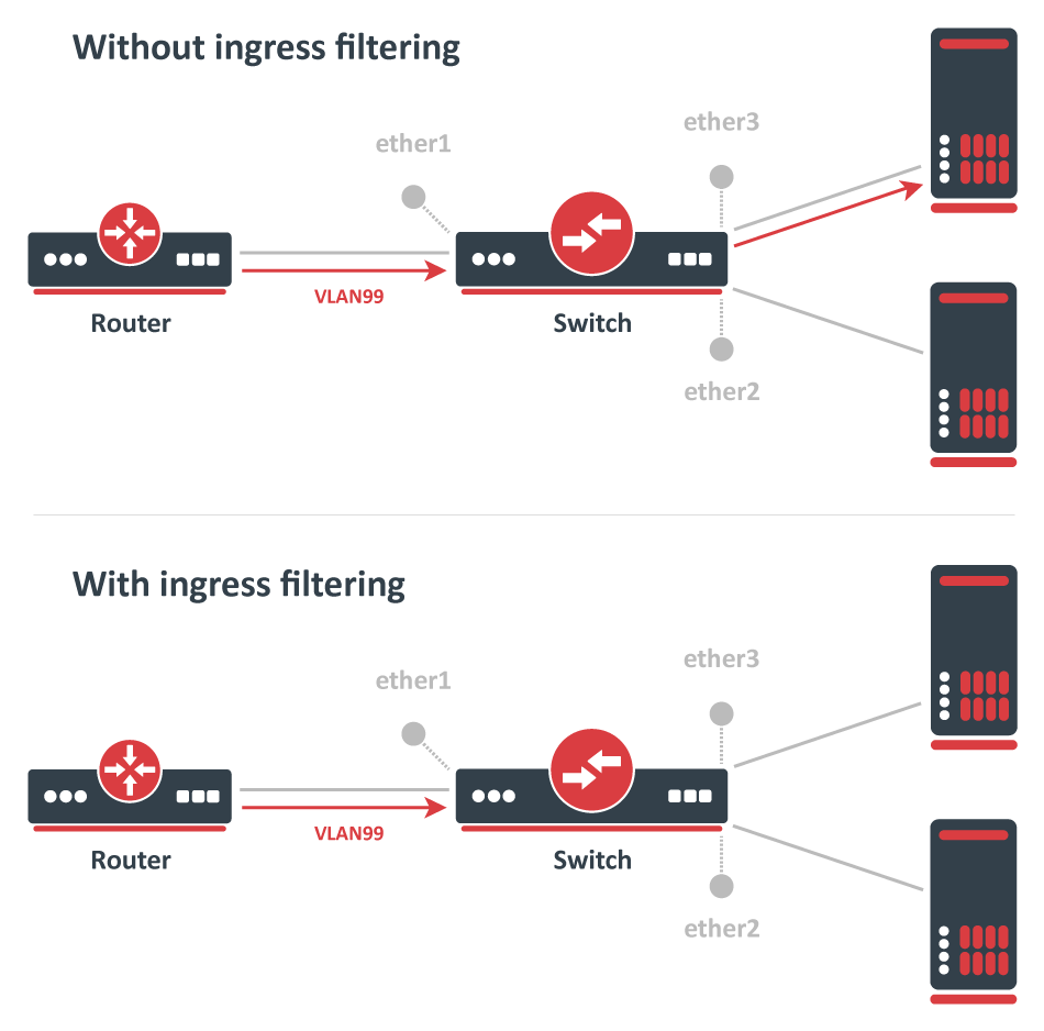

While frame-type can be used to drop a certain type of packet, the ingress-filtering can be used to filter out packets before they can be sent out. To fully understand the need for ingress filtering, consider the following scenario: VLAN99 is allowed on ether3 and bridge1, but you can still send VLAN99 traffic from ether1 to ether3. This is because the bridge VLAN table checks if a port is allowed to carry a certain VLAN only on egress ports. In our case, ether3 is allowed to carry VLAN99 and for this reason, it is forwarded. To prevent this, you MUST use ingress-filtering. With ingress filtering, ingress packets are also checked. In our case, the bridge VLAN table does not contain an entry that VLAN99 is allowed on ether1, and therefore the packet will be dropped immediately. Of course, in our scenario without ingress filtering, the connection cannot be established since VLAN99 can be forwarded only from ether1 to ether3, but not from ether3 to ether1, though there are still possible attacks that can be used in such a misconfiguration (for example, ARP poisoning). The packet dropping behavior is illustrated in the image below:
Trunk/access port setup with and without ingress filtering. Ingress filtering can prevent unwanted traffic from being forwarded. Note that ether1 is not allowed to carry VLAN99 in the bridge VLAN table.
Always try to use ingress-filtering wherever it is possible. It adds a significant layer of security.
The ingress-filtering can be used on the CPU port(bridge) as well. This can be used to prevent some possible attack vectors and limit the allowed VLANs that can access the CPU. It is better to drop a packet on an ingress port, rather than on an egress port. This reduces the CPU load, which is quite crucial when you are using hardware offloading with bridge VLAN filtering.
The ingress-filtering property only affects ingress traffic, but frame-type affects both egress and ingress traffic.

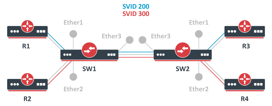

VLAN Tunnelling setup
In some cases, you might want to forward already tagged traffic through certain switches. This is a quite common setup for backbone infrastructures since it provides a possibility to encapsulate traffic from, for example, your edge routers and seamlessly forward it over your backbone to another edge router. Below you can find an example of a VLAN tunneling topology:
Provider bridge topology
SVID stands for Service VID, indicating the tag type along with the VID.
To fully understand how to configure VLAN tunneling properly, you should first read the Trunk/Access port setup section before proceeding any further.
There are two possible ways to achieve this, one is the standardized IEEE 802.1ad way, and the other way is using Tag stacking. We will first review the standardized way since the same principles apply to both ways and only a couple of parameters must be changed to use the other method. The way VLAN tunneling works is that the bridge checks if the outer VLAN tag is using the same VLAN tag as specified in ether-type. If the VLAN tag matches, the packet is considered as a tagged packet, otherwise, it is considered as an untagged packet.
The bridge checks only the outer tag (closest to the MAC address); any other tag is ignored anywhere in a bridge configuration. The bridge is not aware of the packet contents; even though there might be another VLAN tag, only the first VLAN tag is checked.
The ether-type property allows you to select the following EtherTypes for the VLAN tag:
- 0x88a8 - IEEE 802.1ad, Service Tag.
- 0x8100 - IEEE 802.1Q, Customer VLAN (regular VLAN tag).
- 0x9100 - Unofficial tag type (rarely used).
To properly configure bridge VLAN filtering, you must understand how the bridge distinguishes between tagged and untagged packets. As mentioned before, the bridge will check if EtherType matches with the outer VLAN tag in the packet. For example, consider the following packet:
FFFFFFFFFFFF 6C3B6B7C413E 8100 6063 9999
DST-MAC = FFFFFFFFFFFF
SRC-MAC = 6C3B6B7C413E
Outer EtherType = 8100 (IEEE 802.1Q VLAN tag)
VLAN priority = 6
VLAN ID = 99 (HEX = 63)
Inner EtherType = 9999
Let us assume that we have set ether-type=0x88a8, in this case, the packet above will be considered untagged since the bridge is looking for a different VLAN tag. Let's now consider the following packet:
FFFFFFFFFFFF 6C3B6B7C413E 88A8 6063 8100 5062 9999
Outer EtherType = 88A8 (IEEE 802.1ad VLAN tag)
VLAN priority = 6
Inner EtherType 1 = 8100 (IEEE 802.1Q VLAN tag)
VLAN priority = 5
VLAN ID = 98 (HEX = 62)
Innter EtherType 2 = 9999
This time let us assume that we have set ether-type=0x8100. In this case, the packet above is considered as untagged as well since the outer tag is using an IEEE 802.1ad VLAN tag. The same principles apply to other VLAN-related functions, for example, the PVID property will add a new VLAN tag on access ports and the VLAN tag will be using the EtherType specified in ether-type.
Both SW1 and SW2 are using the same configuration:
/interface/bridge
add name=bridge1 vlan-filtering=yes ether-type=0x88a8
/interface/bridge/port
add interface=ether1 bridge=bridge1 pvid=200
add interface=ether2 bridge=bridge1 pvid=300
add interface=ether3 bridge=bridge1
/interface/bridge/vlan
add bridge=bridge1 tagged=ether3 untagged=ether1 vlan-ids=200
add bridge=bridge1 tagged=ether3 untagged=ether2 vlan-ids=300
In this example, we are assuming that all routers are passing traffic that is using a regular/customer VLAN tag. Such traffic on switches will be considered as untagged traffic based on the principle described above. Switches will encapsulate this traffic using a Service VLAN tag (the outer 802.1ad tag) and traffic between SW1 and SW2 will be considered as tagged. Before traffic reaches its destination, the switches will decapsulate the outer tag and forward the original 802.1Q tagged frame. See a packet example below:
A packet example before and after 802.1ad VLAN encapsulation
All principles that apply to the regular trunk/access port setup using IEEE 802.1Q also apply to VLAN tunneling setups. Make sure you are limiting VLANs and packet type properly using the bridge VLAN table and ingress filtering.
In case you want to create management access from, let's say, ether3 to the device and want to use VLAN99, then you would use such commands:
add bridge=bridge1 tagged=bridge1,ether3 vlan-ids=99
/interface/vlan
add interface=bridge1 name=VLAN99 use-service-tag=yes vlan-id=99
/ip/address
add address=192.168.99.2/24 interface=VLAN99
As you may notice, the only difference is that the VLAN interface is using use-service-tag=yes; this sets the VLAN interface to listen to IEEE 802.1ad VLAN tags. This will require you to use the IEEE 802.1ad VLAN tag to access the device using the management VLAN - you will not be able to connect to the device using a regular VLAN tag while bridge VLAN filtering is enabled. The ether-type is set globally and will affect all bridge VLAN filtering functions.
Devices with switch chip Marvell-98DX3257 (e.g. CRS354 series) do not support VLAN filtering on 1Gbps Ethernet interfaces for other VLAN types (0x88a8 and 0x9100).

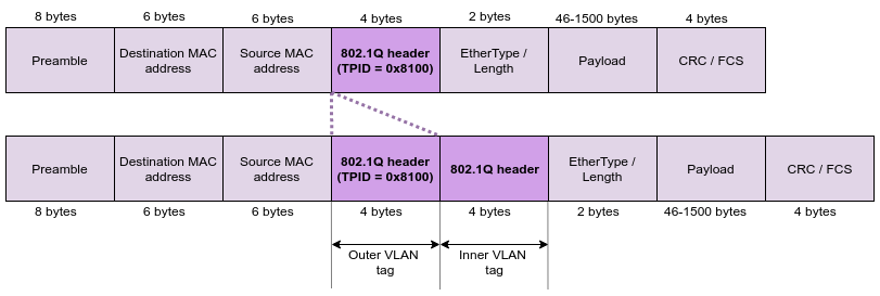

Tag Stacking
In the VLAN Tunnelling setup, we were adding a new VLAN tag that was different from the VLAN tag, but it is possible to add a new VLAN tag regardless of the packet contents. The difference from the regular VLAN tunneling setup is that the bridge does not check if the packet is tagged or untagged, it assumes that all packets that are received on a specific port are all untagged packets and will add a new VLAN tag regardless of whether a VLAN tag is present or not. This is called Tag Stacking since it "stacks" VLAN tags on top of the previous tag, regardless of the VLAN tag type. This is a very common setup for networks that do not support the IEEE 802.1ad standard, but still want to encapsulate VLAN traffic into a new VLAN.
The VLAN tag that is going to be added depends on ether-type and PVID. For example, if you have ether-type=0x8100 and PVID=200 on a port, then the bridge will add a new IEEE 802.1Q VLAN tag right on top of any other tag (if such is present). The same VLAN filtering principles still apply. You have to determine which ports are going to be your trunk ports and mark them as tagged ports, determine your access ports, and add them as untagged ports.
To explain how VLAN tagging and untagging works with tag stacking, let us use the same network topology as before:
What we want to achieve is that regardless of what is being received on ether2 and ether3, a new VLAN tag will be added to encapsulate the traffic that is coming from those ports. Tag-stacking forces a new VLAN tag, so we can use this property to achieve our desired setup. We are going to be using the same configuration as in the Trunk/Access port setup, but with tag-stacking enabled on the access ports:
/interface/bridge
add name=bridge1 vlan-filtering=yes ether-type=0x8100
add bridge=bridge1 interface=ether2 tag-stacking=yes pvid=20
add bridge=bridge1 interface=ether3 tag-stacking=yes pvid=30
add bridge=bridge1 tagged=ether1 untagged=ether2 vlan-ids=20
add bridge=bridge1 tagged=ether1 untagged=ether3 vlan-ids=30
The added VLAN tag will use the specified ether-type. The selected EtherType will also be used for VLAN filtering. Only the outer tag is checked, but with tag-stacking in place, the tag checking is skipped, and it is assumed that a new tag must be added either way.
Let us assume that the devices behind ether2 and ether3 are sending tagged VLAN40 traffic. With this configuration, ALL packets will get encapsulated with a new VLAN tag, but you must make sure that you have added the VLAN ID from the outer tag to the bridge VLAN table. VLAN40 is not added to the bridge VLAN table since it is the inner tag and it is not checked; we are only concerned about the outer tag, which is either VLAN20 or VLAN30 depending on the port.
Similar to other setups, the bridge VLAN table is going to be used to determine if the VLAN tag needs to be removed or not. For example, when ether1 receives tagged VLAN20 packets, the bridge checks that ether2 is allowed to carry VLAN20 so it is about to send it out through ether2, but it also checks the bridge VLAN table whether the VLAN tag should be removed and since ether2 is marked as an untagged port, the bridge will forward these packets from ether1 to ether2 without the VLAN20 VLAN tag.
From the access port perspective, the same principles as in the Trunk/Access port setup apply. All packets that are received on ether2 will get a new VLAN tag with the VLAN ID that is specified in PVID, in this case, a new VLAN tag will be added with VLAN20 and this VLAN will be subjected to VLAN filtering. See a packet example below:
A packet example before and after tag stacking
